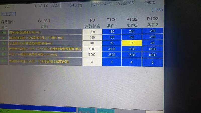

2、森精精机U450机型为AC机构,支持RTCP,A轴加工行程+-120度,四轴松轴指令M82  锁轴M81  五轴松轴指令M84  锁轴指令M83,支持高速高精加工模式
set L14 {G90 G53 X-280.}
set L15 {M01\nG90 G53 X-280.}
set L36 {G90 G53 Y280.}
set L38 {G00 G90 A0. C0.F4000}
set L120 {A}
set L121 {X}
set L122 {4+}
set L123 {0}
set L124 {-120}
set L137 {G53 G90 Z-1.}
set L19 {G120.1 P1Q1}
set L20 {G120.1 P1Q2}
set L21 {G120.1 P1Q3}
set L29 {G121}
备注:Q1为开粗   Q2中光   Q3光刀
