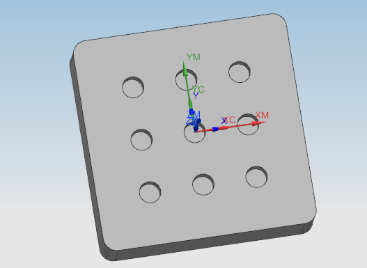

钻孔后的坐标是增量值不是绝对值
怎么改
Xmin-Xmax:-20.000 mm ~ 20.000 mm
Ymin-Ymax:-20.000 mm ~ 20.000 mm
Zmin-Zmax:-5.000 mm ~ 30.000 mm
=============2=1=0=8=0=1==============
(Sun Aug 15 18:04:55 2021)
(TIME=0.53 MIN)
(==========TOOL LIST START=========)
(刀号--刀补--径补--切削深度--刀具名称)
(T02 | H02 | D00 | -5.000 | D3)
(==========TOOL LIST END===========)
G17 G40 G49 G80
G91 G28 Z0.
(D=3.00 R=0.00)
N1 T2 M06
S1000 M03
G17 G00 G91 G54 X-20. Y-20. A0.0 M08
G43 Z30. H02
G98 G81 X0.0 Y0.0 Z-35. R3. F250.
X20.
X20.
Y20.
X-20.
X-20.
Y20.
X20.
X20.
G80
Z35.
M05
M09
G91 G28 Z0.
M30

跳步L113设为NO
set L113 {NO}    ;#L113*_钻孔作为跳步主程序调用子程序_
