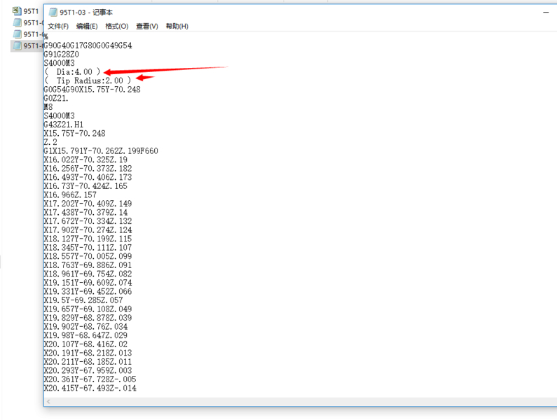

R2的球刀就直接R2,不要上面D4下面R2,操机看错几回了,请老师帮忙修改,谢谢

请老师帮忙修改PM程序头刀具显示信息 图152005

发表于 2018-9-22 14:38:24 | 显示全部楼层
G90G40G17G80G0G49G54
G91G28Z0
S2000M3
( D = 17.  R = 0.8 )
修改TD和TIPR格式如下
define word TD
   address letter = " D ="
    address width              =   5
    field width                =   5
    exponent width             =   0
    scale factor               =   2
    scale divisor              =   1
    tape position              =   0
    print position             =   1
    sign                       = none
    not permanent
    not modal
   metric formats
    leading zeros              = false
    trailing zeros             = false
    decimal point              = true
    decimal places             =   3
end define
define word TIPR
   address letter = "  R ="
    address width              =   6
    field width                =   3
    exponent width             =   0
    scale factor               =   1
    scale divisor              =   1
    tape position              =   0
    print position             =   1
    sign                       = none
    not permanent
    not modal
   metric formats
    leading zeros              = true
    decimal places             =   3
end define
已修改好的后处理,请测试
