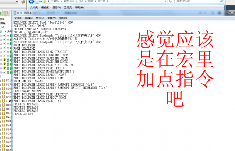

请问用宏调用模板之后的名字怎么设置成1 2 3 4 5 6......求指点 EXPLORER SELECT Tool "Tool\D8-B" NEW ACTIVATE Tool "D8-B" IMPORT TEMPLATE PROJECT FILEOPEN "D:\HO\开粗\D8-H.ptf" EXPLORER SELECT Toolpath "Toolpath\1-1\文件夹1\1" NEW ACTIVATE Toolpath # //#号代替最新的元素 EXPLORER SELECT Toolpath "Toolpath\1-1\文件夹1\1" NEW FORM TOOLPATH FORM LEADLINK EDIT TOO……
查看: 3094|回复: 2
[PowerMILL] 请问用宏调用模板之后的名字怎么设置成1 2 3 4 5 6......求指点
发表于 2018-8-7 13:55:45 | 显示全部楼层 |阅读模式
悬赏10推广未解决
"D:\HO\开粗\D8-H.ptf"
FORM TOOLPATH
FORM LEADLINK
EDIT TOOLPATH LEADS LINK STRAIGHT
EDIT TOOLPATH LEADS LONGLINK INCR
EDIT TOOLPATH LEADS SAFELINK SKIM
EDIT TOOLPATH LEADS PAGE ZHEIGHTS
EDIT TOOLPATH LEADS PAGE FIRSTLEADIN
EDIT TOOLPATH LEADS PAGE LEADIN
EDIT TOOLPATH LEADS MOVESTARTPOINTS Y
EDIT TOOLPATH LEADS LEADOUT COPY
EDIT TOOLPATH LEADS LEADIN RAMP
FORM PMLLEADINRAMP
EDIT TOOLPATH LEADS LEADIN RAMPOPT ZIGANGLE "0.7"
EDIT TOOLPATH LEADS LEADIN RAMPOPT HEIGHT_INCREMENT "0.4"
LEADINRAMP ACCEPT
EDIT TOOLPATH LEADS PAGE LEADSOUT
EDIT TOOLPATH LEADS LEADOUT NONE
EDIT TOOLPATH LEADS PAGE LINK
PROCESS TPLEADS
PROCESS TPLEADS
PROCESS TPLEADS
LEADS ACCEPT

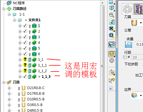

请问用宏调用模板之后的名字怎么设置成1 2 3 4 5 6......求指点 图148209
请问用宏调用模板之后的名字怎么设置成1 2 3 4 5 6......求指点 图148210

设置变量,PM2017测试OK,宏程序修改如下:
DIALOGS MESSAGE OFF
DIALOGS ERROR OFF
STRING $str=input "请输入刀具路径名称"
RENAME Toolpath "1" "YSUGPM"
RENAME Toolpath "1" $str
RENAME Toolpath "YSUGPM" "1"
ACTIVATE Toolpath $str
FORM TOOLPATH
FORM LEADLINK
FORM PMLLEADINRAMP
LEADINRAMP ACCEPT
PROCESS TPLEADS
PROCESS TPLEADS
PROCESS TPLEADS
LEADS ACCEPT
