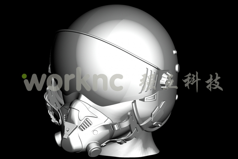

The whole part is machined with just 4 strategies: Global Roughing
Global Roughing
Z level Finishing (areas steeper than 30 degrees)
Optimised Z level Finishing (areas shallower than 45 degrees)
Contour Remachining
整个零部件加工仅用了四种加工策略:
全局粗加工
等高精加工(加工斜度大于30度的区域)
最佳化等高精加(加工斜度大于45度的区域)
轮廓再加工

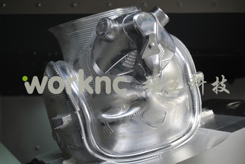

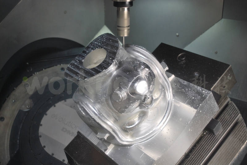

Global Roughing is used for initial roughing from both sides with Ø16mm R1 run at 5000mm/min, followed by Ø8mm ball at 4200mm/min, Ø6mm ball at 3200mm/min and Ø4mm ball at 4200mm/min.
全局粗加工时,首先使用D16 R1的刀具以5000mm/min的进给速度对头盔两侧进行原始开粗,随后依次用D8 球刀以5000mm/min,D6 球刀以3200mm/min,D4 球刀以4200mm/min进给速度进行开粗。
It is even used with Ø2mm & Ø1mm ball cutters to rough some detail areas at 800mm/min from a variety of angles to get into all the hard to access areas.
WorkNC甚至支持D2和D1 球刀,以800mm/min的进给速度,从多个角度对不易进入的区域进行再次开粗。
All the main finishing is done with Ø6mm ball from both sides running at 1760mm/min.  The final remachining is then carried out to pick out all the detail from many different angles using Contour remachining with Ø2mm & Ø1mm ball cutters. This strategy is able to adapt to a Z level cutting method where the geometry is steeper and then back to a contouring method on the shallower areas. It is also using an “evolving” stepover where the passes morph to suit the changing radii that the cutter is following, to give a better surface finish in the corners.
两侧主要精加工均由D6球刀以1760mm/min的速度完成。然后使用最终再加工策略,用D2和D1刀具从不用角度加工余料残余区域。对于斜度较大的区域,采用等高精加工。对于斜度较小区域,采用等高精加工。随时识别步距变化,调整合适的刀具,保证局部精加工的表面品质。

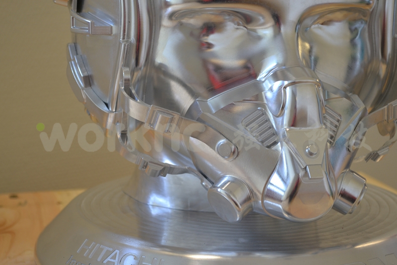

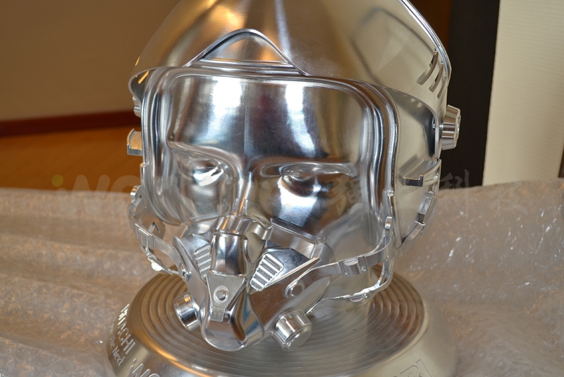

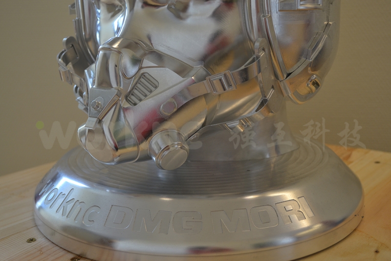

WorkNC partnered with DMG Mori Seiki and Hitachi Tool to produce an intricatelifesize model of a pilot’s head and helmet for displaying on their booth at the Le Bourget International Paris Air Show in June.
WorkNC合作德马吉森精机和日立刀具加工复杂、逼真的飞行员头盔模具,并展示于6月布尔歇国际巴黎航空展。
The bust was machined from 10 aluminium blocks using WorkNC’s diverse 2D 3-axis, 3+2-axis and 5-axis toolpaths, all programmed with the latest release, Version 24.
此头盔由10个铝块加工而成,使用了WorkNC 2D 3轴 、3+2轴、5轴刀路,所有程序皆由当时最新版本WorkNC 24完成。

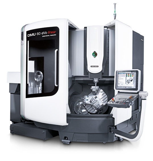

Thanks to the new Transformation functionality, toolpaths only had to be created for half the helmet. Symmetrical toolpaths were then reproduced with a single mouse click, eliminating additional calculation time, meaning the Mori Seiki DMU 60 eVo linear machine could start cutting metal considerably sooner.
得益于WorkNC的自动转化功能,只需要编辑头盔加工的一半刀路即可。单击鼠标自动生成对称的另一半刀路,缩短了额外计算时间,这意味着能够更快用于德马吉森精机 60 eVo linear进行加工。
DMG Milling Product Manager Denis Vernier says: “And there was never any danger of a costly collision, as WorkNC’s collision detection function includes the machining environment, tool holder, stock, and the machine itself.”
“Adjustments were not required to the post processor – the initial program was operational immediately, and whether it was a question of 5-axis positioned or 5-axis simultaneous strategies, the different machining phases succeeded each other seamlessly.”
DMG铣床产品经理 Denis Vernier说:“WorkNC能够对加工环境、刀柄和机床进行干涉碰撞检测,不会发生撞机,有效节约了成本。”“不需要调整后处理—可以直接使用初始程序。无论是5轴定位还是5轴联动加工,WorkNC都能够无缝连接不同加工阶段。”
WorkNC CAD/CAM Applications Engineer Jean Philippe Rey says the DMU 60 eVo was ideal for producing the extremely complex helmet, as it combines the flexibility of modern universal milling machines with the performance of vertical machining centres. Using cutting tools from Hitachi, the NC swivelling rotary table allowed 5-axis simultaneous interpolation for optimal surface machining.
WorkNC CAD / CAM应用工程师Jean Philippe Rey表示,DMU 60 eVo结合了现代万能铣床的灵活性和立式加工中心的高性能,非常适合加工极其复杂的头盔。利用日立刀具,NC回转工作台允许5轴同时插补,实现最佳表面加工。
