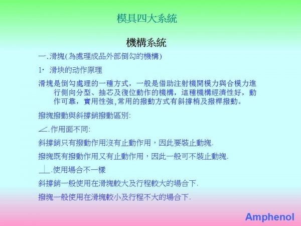

注塑模具四大系统之机构系统详解 图124519

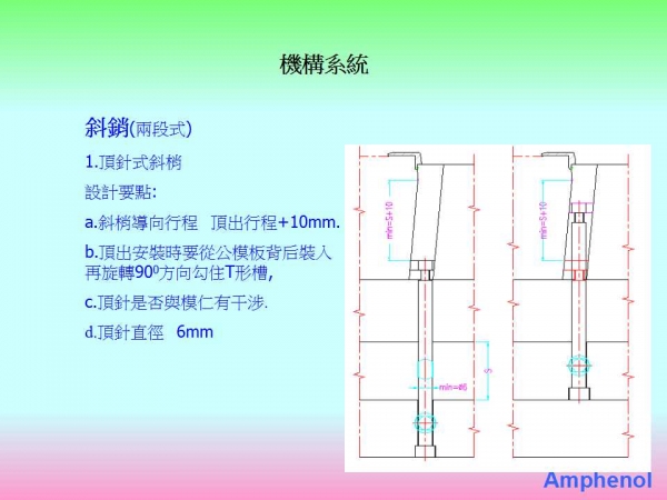

注塑模具四大系统之机构系统详解 图124520

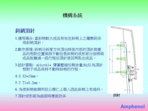

注塑模具四大系统之机构系统详解 图124521

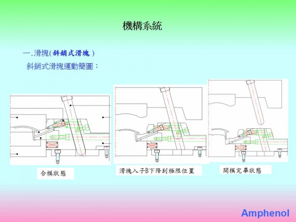

注塑模具四大系统之机构系统详解 图124522

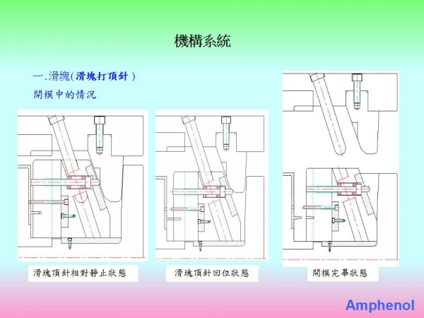

注塑模具四大系统之机构系统详解 图124523

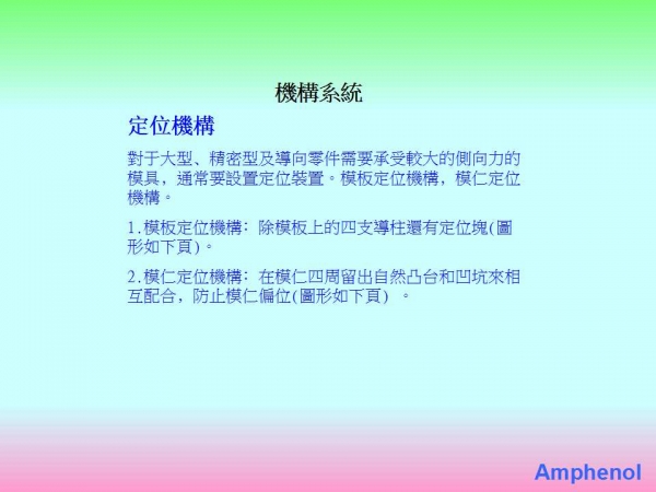

注塑模具四大系统之机构系统详解 图124524
