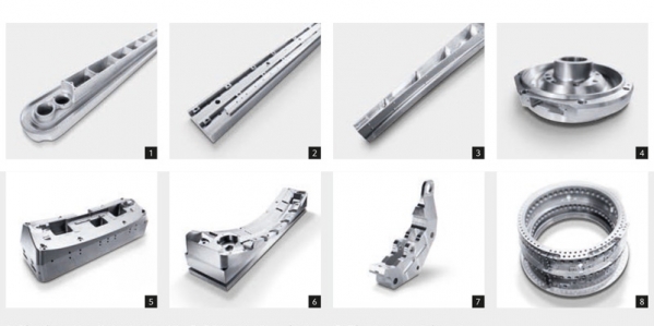

Aravis installed WorkNC when the company was founded 15 years ago, and use it to manufacture a wide range of parts and mould tools for automotive, sports, mechanical construction, industrial maintenance and aeronautics clients.
Aravis在15年前成立便已安装了WorkNC,并用它为汽车、运动、机械制造、工业维护、航空等领域客户制造各种零件和模具工具。

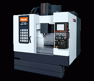

Operating from 600 square metre premises in Thônes, France, with nine employees, Aravis use WorkNC to program a recently-acquired 5-axis DMG DMF180 CNC machine, along with two Hurco 30s and 3-axios VMX 42S, and a 3-axis Mazak Nexus 410A with a 4th axis.
Aravis在法国Thônes有600平米的厂房,9个员工。WorkNC被用来配套一台最近购置的5轴德玛吉DMF180 数控加工中心、两台赫克Hurco 30s和3-axios VMX 42S和一台带第四轴的3轴马扎克Mazak Nexus 410A机床。

Mazak Nexus 410A
WorkNC模具加工案例 图122444

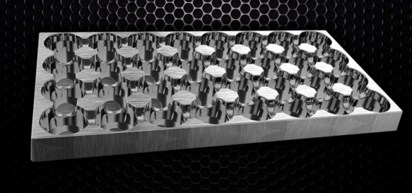

Their most frequently used toolpaths are the standard roughing strategies, Z-level finishing, and optimised Z-level finishing. “Thanks to the quality of the rapid and reliable finishing toolpaths, the part requires very few further conventional milling phases.”
他们在编辑刀具路径时最常用的是标准的粗加工策略,等高精加工和最佳化等高精加工等高精加,由于WorkNC高品质的高效可靠的精加工刀具路径,零件很少需要进行再精加工的铣削阶段。
WorkNC模具加工案例 图122436

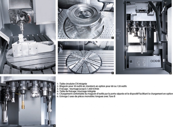

Before acquiring the 5-axis DMG Mori Seiki machine in September 2014, Aravis produced straightforward standard parts using 4-axis strategies. Using this latest machine, programmed with WorkNC, they manufacture new products almost daily, including single or small series parts which require specific production processes with new machining sequences and new tooling equipment.”
在2014年9月购买德玛吉5轴DMG Mori Seiki 设备之前,Aravis使用4轴策略生产简单的标准部件。现在使用这台最新的机器,用WorkNC进行编程,几乎每天都生产新的产品,包括需要新的加工工序和新的加工设备的特定的单个或者小系列零件的生产。

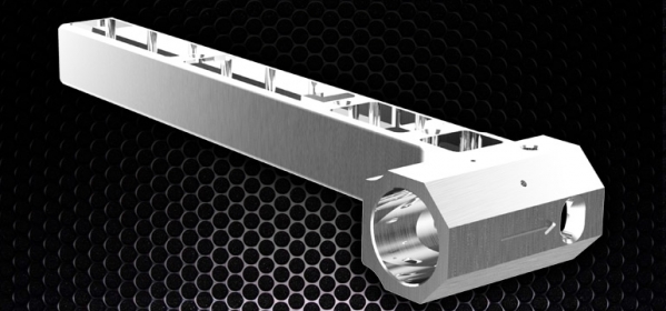

A steering column for a Grand Prix Moto2 motorbike chassis is a perfect example of how this has revolutionised the way they work. “It’s a particularly complex component, and on 3-axis machines it required eight operations and additional finishing. But using WorkNC on the 5-axis DMG it only requires two machining operations and the surface finish is of a remarkably high standard.
如何彻底改变加工方式, moto2大奖赛的摩托车底盘转向柱是一个很好的例子,它是一个特别复杂的组件,在3轴设备上加工它需要8个操作步骤以及需要多次精加工,但是用WorkNC编程在5轴的德玛吉DMG上加工只需要2个操作步骤且它的表面品质能达到相当高的标准。
WorkNC模具加工案例 图122446
