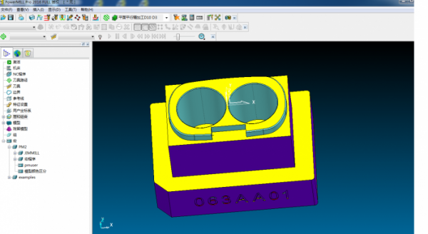

[PowerMILL] 这个变颜色的宏怎么添加到右键菜单?整好久都没搞定
发表于 2017-6-18 19:43:13 | 显示全部楼层 |阅读模式
DIALOGS MESSAGE OFF
DIALOGS ERROR OFF
GRAPHICS LOCK
VIEW MODEL ; SHADE RAINBOW
EDIT MODEL ALL DESELECT ALL
//平坦面 黄色
EDIT SELECTUNDERCUT MODEL ALL FORM SELECTUNDERCUT
VIEW MODEL ; UCANGLE "90"
EDIT SELECTIONTOOLS MATCH_DRAFT_ANGLE YES
EDIT SELECTIONTOOLS INCLUDE_PARTIALS NO
FORM APPLY SELECTUNDERCUT
VIEW MODEL ; UCANGLE "-90"
FOREACH Model IN FOLDER('Model') {
    INT i =number_selected(Model.Components)
    IF i>0 {
      EDIT MODEL $Model.Name COLOUR RGBSELECT
      RGB 1.00000 1.00000 0.00000
//垂直面 紫色
VIEW MODEL ; UCANGLE "0"
    IF i>0 {
      RGB 0.50196 0.00000 1.00000
//倒扣面 红色
VIEW MODEL ; UCANGLE "-0.01"
EDIT SELECTIONTOOLS MATCH_DRAFT_ANGLE NO
EDIT SELECTIONTOOLS INCLUDE_PARTIALS YES
    IF i>0 {
      RGB 1.00000 0.00000 0.00000
FORM ACCEPT SELECTUNDERCUT
//曲面
EDIT SELECTION SMART NO FORM MODELSELECT
EDIT SELECTION APPROXIMATE 'web'
EDIT SELECTION MODEL FILTER "255,0,0"
EDIT SELECTION MODEL FILTER "255,255,0"
EDIT SELECTION MODEL FILTER "128,0,255"
FORM CANCEL MODELSELECT
    IF i>0 {
      EDIT MODEL $Model.Name SELECT INVERT ALL
      RGB 0.50196 1.00000 1.00000
    IF i>0 {
DIALOGS MESSAGE ON
DIALOGS ERROR ON
GRAPHICS UNLOCK
