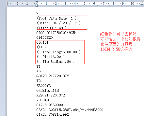

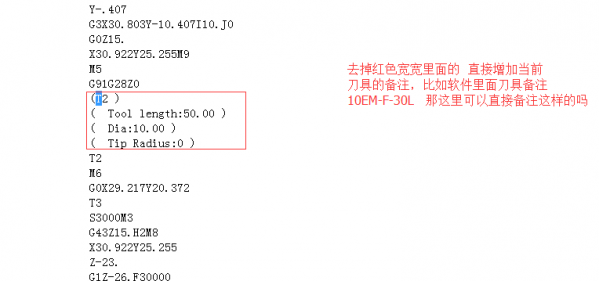

[PowerMILL] 我是网络学员,有个后处理需修改,请帮下忙!
发表于 2017-4-26 19:39:59 | 显示全部楼层 |阅读模式
求:PM法拉科带刀库后处理,附带一个本厂目前使用的MC9.1后处理,麻烦老师修改下
mary.rar (15.33 KB, 下载次数: 68)

      "(", pstrtool, *tnote, *toffnote, *tlngnote, *tldia, ")", e
pstrtool        #Comment for tool
      if strtool <> sblank,
        strtool = ucase(strtool)
        *strtool, " "

      "(PROGRAM NAME -", sprogname, ")"
      "(DATE=DD-MM-YY - ", date, " TIME=HH:MM - ", time, ")", e
      pbld, "G91", "G28", "Z0.", e
      pbld,  "G90", "G80", "G00", "G17", "G40", "G54", "G21", e

ptlchg          #Tool change
      pcuttype
      toolchng = one
      if mi1 = one, #Work coordinate system
        pfbld,  *sg28ref, "X0.", "Y0.", e
        pfbld,  "G92", *xh, *yh, *zh, e
      # pbld,  *t, e
      pbld,  "M01", e
      *N,e
      pcom_moveb
      c_mmlt #Multiple tool subprogram call
      ptoolcomment
      comment
      pcan
      pbld, *t, e
           "M6", e
      pbld, *next_tool, e

发表于 2017-4-26 20:23:38 | 显示全部楼层
请测试反馈!
PM自动换刀法兰克.rar (3.77 KB, 下载次数: 60)
 楼主| 发表于 2017-4-27 10:17:22 | 显示全部楼层
好的  谢谢
 楼主| 发表于 2017-4-28 09:07:40 | 显示全部楼层
老师,我测试了下,看能不能在帮我修改下
